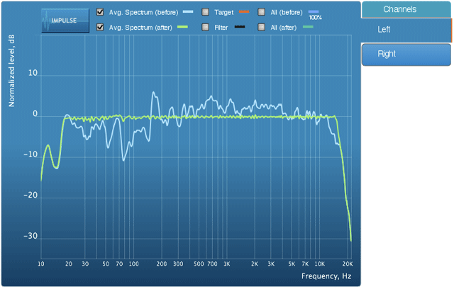

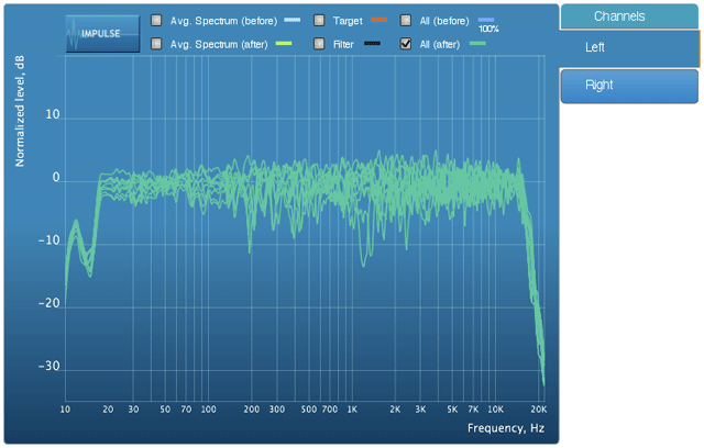

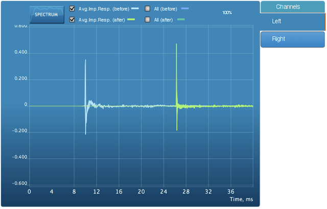

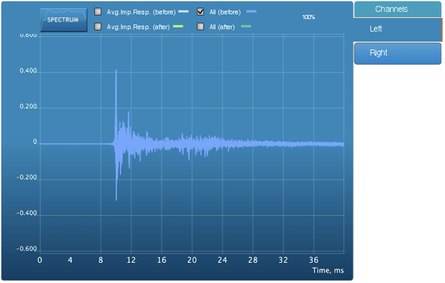

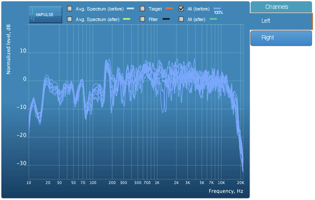

The following screen captures illustrate the filter application for my left channel. The software ignores data below 20Hz and above 15kHz, which is why the frequency response graphs drop off beyond those points.
Correction: Dirac informs me that the software does measure above 15kHz. The drop off is due in part to the external USB sound card I used with the microphone. Dirac Live RCS does not support a sound card calibration file at the moment but they agree it is a good feature to add.
The original frequency response measurements for the nine measured positions.
The post-filter predicted frequency responses at the nine measurement positions.
The original measured average and predicted average frequency response.
The original impulse response measurements for the nine measured positions.

The original measured average and predicted average impulse response.
